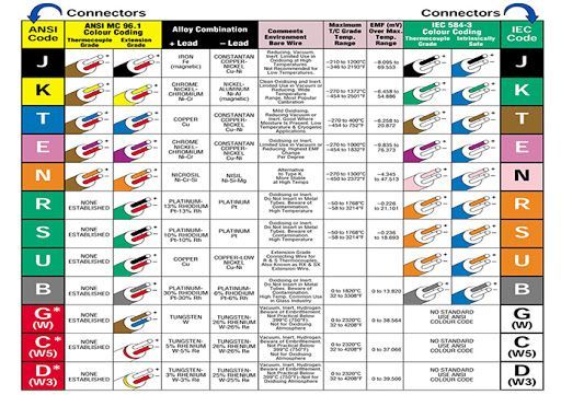

In addition to what RTSLVU stated-
It appears that you are not using K-Type T/C wire- this will cause measurement errors.
-AK2DM
"It’s the questions that drive us.”
Message 9 of 13
(2,638 Views)
-AK2DM
I said that too but when I looked for a table to post I noticed the IEC color code is Green with Green/White wire for K type
=== Engineer Ambiguously ===
