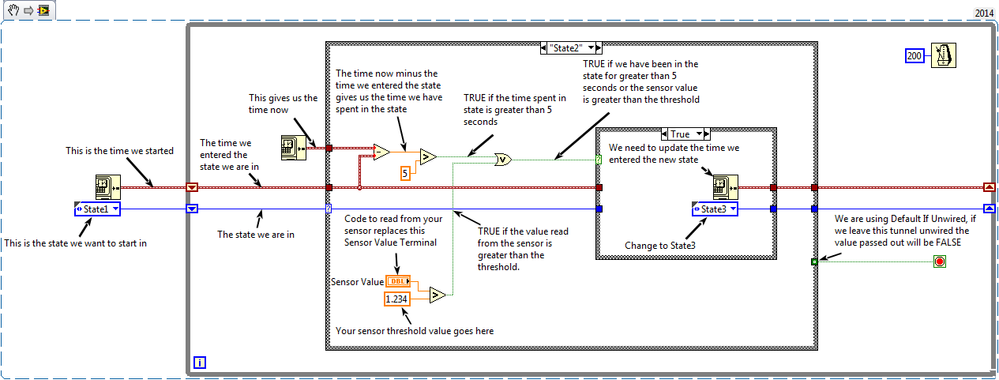

Hi Hatem
I think the issue is that you cannot simply wait in your State2 (for 5 seconds) as you have to be continually looking at your level sensor?  If you are waiting you can't look at your sensor value.  So your state machine needs to remain in a state up to a maximum time whilst making decisions based on the sensor level.
I put this together for you.  It is not supposed to be a solution (or even be functional), that's down to you, but should give you some hints towards where I think you need to be.
NOTE:  Constant values are convenient but you may want to avoid using them or at least comment them Smiley Wink.
Steve

Hi Steve,
That is exactly what i mean, I have to look continually at the sensor.
thanks for your help, I will to use what I can from them, then I will be back here; hopefully with "SOLVED" 🙂
