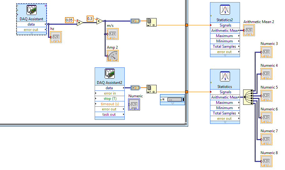

I have a NI cDAQ that couldn't read a counter signal and analogic signals at the same type
So my problem is i need adquire 1 counter signal and severeal analogic signals ( current and voltage) and make statistics of 300 measures with the frequency of 10hz (0.1seconds), i can not wait 30sec to read this 2 different signal i use to diferents cdaq assistant but i don't know how i may do the conections with de statistics

You have to draw wires from the data output of the DAQ assistent to the Signals input of the Statistics ExpressVI...

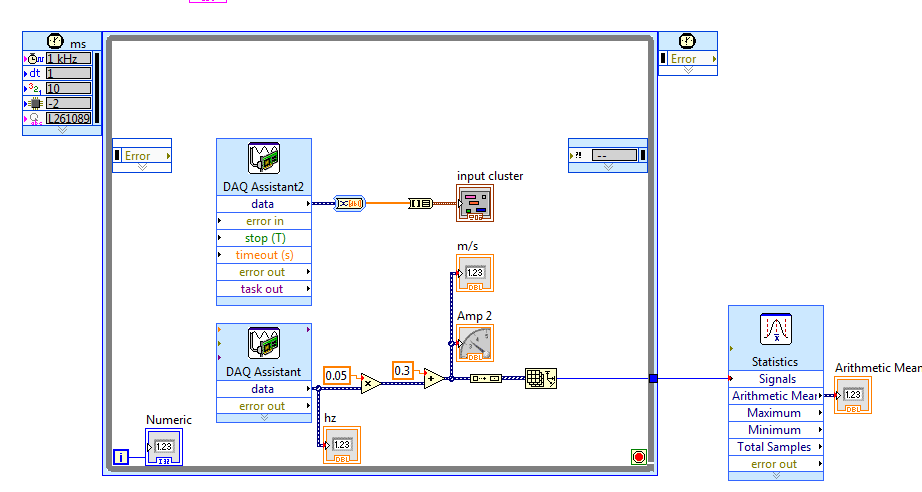

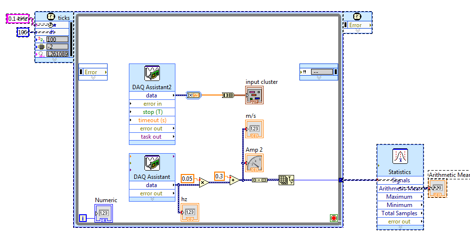

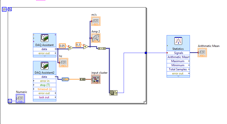

i had try this 3 way's
in this way my result is 1
and the next 2 way's the 1st doesn't work and the 2sd never stop

Take a look at the tutorials GerdW recommended.  They should help you out.  In all three cases you are only going to get a the last value out of the loop.  I know this by looking at the tunnel coming out of the loop (the little square solid box your wire is attached to).  If you want to get all your samples you will need to build it into an array.  There are lots of ways to do this but the easiest is to enable auto indexing.  This will create an array of all the values out of the loop.  You can do this by right clicking the tunnel and selecting "enable indexing".  It will change the way it looks as well.  In the image below the top tunnel has auto indexing enabled and the bottom does not so you can see the difference.
That being said I don't know that you actually need to use a loop.  If you know how many samples you need to take (and it sounds like you do) you can simply set the DAQ Assistant to acquire N samples.  When this is done it will just take N number of samples and then stop and output the data.  You can wire this to the Statistics VI.
