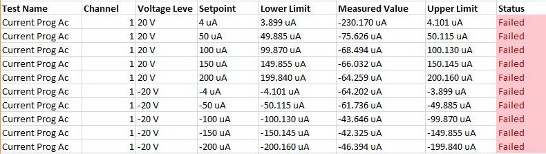

Hey Brandon,
I've attached the Step Message Log of my previous test as what you have aked me. Hope you could take a look on this.
And also, I've observed that my 5520A is configured to 4-wire by the Cal exe software since I didn't saw the "4-wire" text on the display? Maybe your your right that the failure I'm seeing is due to the 5520A not being configured properly because it's not receiving the proper commands from Cal Exec.
I've tried to configured manually the calibrator to the resistance values in Table 4 in the Calibration Manual, connect the wiring per Figure 2, set the calibrator to External sense (4-wire mode), set the 4130 to the appropriate current level using Soft Front Panels, and verify the voltage is correct using the DMM. I've tested it in 200uA range @ 50uA test Value and 20mA range @ 15mA test value. And the result was good as it passed to the given test limit.
I therefore, conclude that the failure is due to instrument's command not receiving properly? What do you think?
The fact that I might damage the calibrator if the allowable current is exceeded is enough reason in this matter. Thanks!
Cris

Hey Cris,
I took a look at the log file and I can't make any deductions from the log file on what may not be configured properly on the calibrator.  In the 200 uA Current Programming Accuracy Measurements for example the measurements are all negative and vary from -230 uA to -42 uA.
The -230 uA to -42 uA would mean the DMM is measuring -2.30 V to -.42 V which I'm not sure how the calibrator would have to be configured to read such values.  Since you have tested the 4130 outside of Cal Exec, with the same pieces of equipment and received good measurements, I'm inclined to agree with you and say the calibrator is not being configured the same way from when you performed manual measurements vs. Cal Exec configuring (or attempting to configure) it automatically.
In any event, the outcome would be the same; the 5520A will not be a good solution to calibrate the 4130.  I would expect a much more user-friendly experience when using either the 5700A or 5720A approved instruments.
