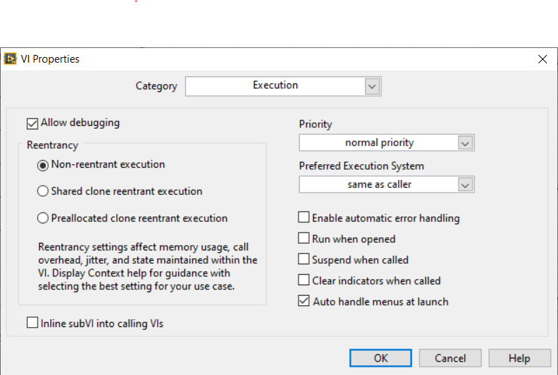

Make sure "Clear indicators when called" is not checked off or selected. If it is, the .vi will open it's front panel to indicate that this option is not supported in RT. You can see the error message (warning) in the Deployment Progress log each time you run (deploy) the RT .vi

I am using LV2020 SP1 and still having the same issue, I have tried the solutions proposed in this topic, but none of them worked.
It is even possible to get rid of these pop ups?

If I recall correctly DQMH Main VIs still pop up for us (on PharLap Systems with LV2020 32bits SP1). We don't deploy as often as we used to; now we're mostly running on compiled .rtexe without GUI.
For generic sub-VIs, unchecking "Clear indicators when called" as indicated above worked nicely for us.
NI may be working to fix this issue, but I don't expect they'll fix it for older LabVIEW versions or PharLap.

FYI, this behaviour was reported as bug #1876112 at the end of 2021. We worked with NI and the bug was eventually fixed in LabVIEW 2022.
Big kudos and thank you for this fix goes to David Corney!
