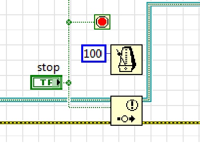

As you can see, the program has 2 stop buttons.  The one inside the tab is to stop charging of an electric vehicle prototype whereas the one outside is for stopping the while loop and labview program. Both stop buttons are wired to the same conditions except the additional function of the 2nd stop button for passing notification i.e.:
The labview program is connected to the EV hardware through c-RIO system via ethernet, which uses NI 9411 for updating the charging status of the EV prototype. The issue is: while the 1st stop button causes the counter value of NI 9411 to fall thus updating the charging status of EV, the 2nd one just stops the program and goes back to the first page and the status remains the same (even though this can be modified for display in the labview program, it cannot be changed in the hardware). What do i need to do to update EV status before stop button makes the program exit and goes back to the start page of the program?

Hi but the two stop buttons are necessary for this application as the internal stop button is present on this page of the the tab. If the user wants to stop the program earlier, he has to do so using the external stop button [the abort button in the toolbar is made invisible to avoid confusion]. As seen in ControlEV.vi, the CTR0 value must drop to a value below 100 (value is usually 49.25 when internal stop button is pressed) and it has to go through a series of steps: Unlock >> init >> relays before the program stops and returns to the welcome page. this would cause the charger plug to be unlocked from the EV plug point and EV plug point would change from blinking red to green/ blue.
