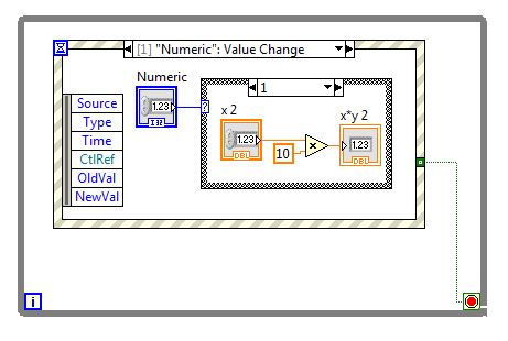

So you want to run the execution once? Perhaps something like below? The code inside events structure can run only when the events source is triggered. For example, the code within the Numeric only runs when it detects a change in numeric value (just an example).

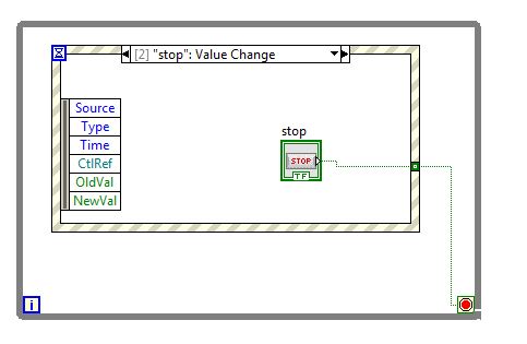

When the stop button is selected, it should trigger the stop event as shown below:

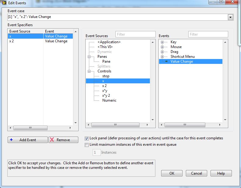

If you want to create the event source, create the event structure >> right click on the frame and select edit events handled this case... >> this should open the Edit Events.

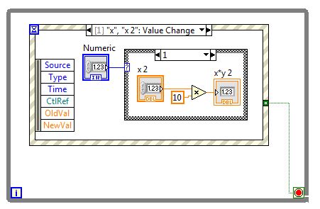

The example below is that I have set the events source to be the change of value of x and x2.
So when either x or x2 value changes, the code within the event subdiagram shown below will execute.
