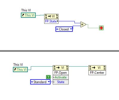

I have solved this problem in a different way (upper part). Remember to add a command that re-open the frontpanel when the vi is lunched (bottom part).
You added to an 8 year old thread with a cryptic message. You probably want to explain to all of us in much more detail why you think this is a good solution. Your suggestion needs to constantly poll the front panel state with each iteration of the loop, which seems like a waste of resources.

So what is wrong?
I have just used @giancarlotamburello's code.
So far it seems to work for me.

@Станев wrote:
So what is wrong?
Read the post right above yours.
