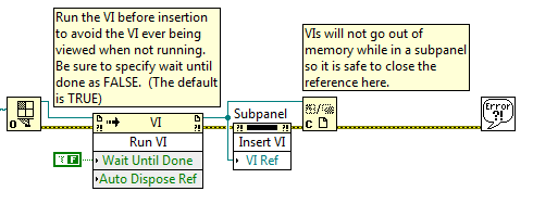

Hi Kudu,
What you're looking to do is pretty common and fairly straightforward.  There are examples to do what you're wanting in your LabVIEW help.  With context help enabled, hover your mouse over the Insert VI method in your code, and click on detailed help.  This will bring up the Insert VI Method help (also online here, but your local help will be easier to navigate), which has several examples at the bottom.
Just emulate what's going on in those VI's and you should be fine.  I've included a screenshot for reference:
Basically you need to use VI Server to run the VI before putting it into the Subpanel.  I inserted the Run VI Invoke Node in your code and it worked fine with both panels open.
Also, to run a specific test when each button is pressed, please research the User Interface Event Handler design pattern.  From File New..., select User Interface Event Handler from the VI->From Template->Frameworks->Design Patterns tree menu.
A bit more information is available here under download presentation files, but the best info is probably in the LabVIEW Basics II class.  I prefer a queue driven state machine, but that may be overkill for what you're trying to do.
Good luck and let us know how it goes.
