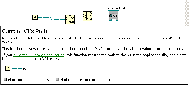

You are using a "Current Vi's Path" function.  When part of a build, it does not return what you expect.  You can experiment by displaying the path before & after you build.  The difference is that after you build, it will point to the exe that you created, because that's where it now is..
Read the info below in the attached image:
RayR

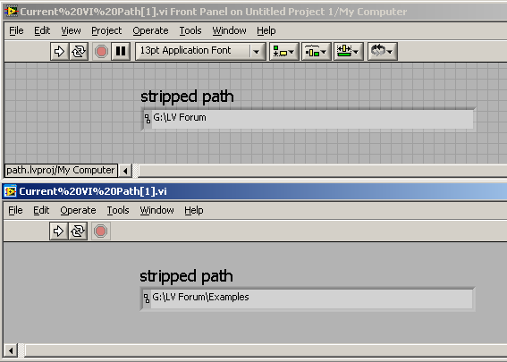

Look at the difference between the two results.  Both VI & exe are in the same folder..
