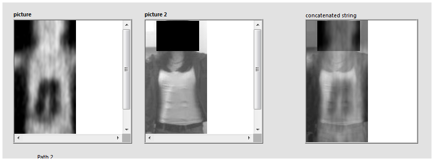

This is what I get when I run the top part of your code:
I can't comment on the IMAQ code since I don't have it installed.
