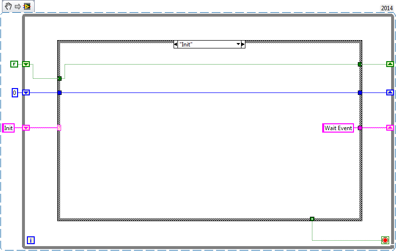

Hi Fendy,
Here is an example of a state machine. In the "Check Time" case, you can replace "Wait Event" with whatever states you want to do during the alotted time after the button press.On Timer.png
