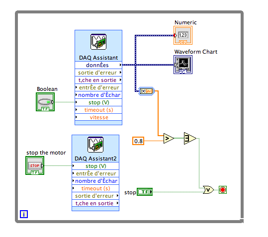

I made a diagram to acquire the power that comes from photdiode and displayed as a graph and digital at the same time and also I made a diagram of pulse output with a meter to check the circuit impultion engine but the problem is how to stop the second VI Indicator nimirique detect when a voltage xx volt

Post the VI you have so far.  It sounds like you just need to use a comparison function to stop a loop based on the measured voltage.

hello Ravens I'm sorry for the delay here is my vi

What do you expect? That VI runs each DAQ Assistant one time and quits.
Are you using the Run Continuously button? STOP! That button is only for specialized troubleshooting and not for routine operations. Place your code in a while loop. Connect a Stop button and the comparisons and logic needed to stop the program when the photodiode voltage reaches the threshold.

Here is a simple way to compare the readings to a threshold (set to 0.8 because you mentioned that value). If any reading (even just one noisy sample) is above 0.8 the VI will stop. It will also stop if the user presses the stop button on the front panel.
0.8 V sounds rather high for a photodiode. Are you sure your device generates that much voltage?
A better program would guarantee that the motor is stopped before the program stops.  I did not try to figure out how your system works to include that cpability. You can work on that.
