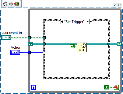

The Functional Global Variable:

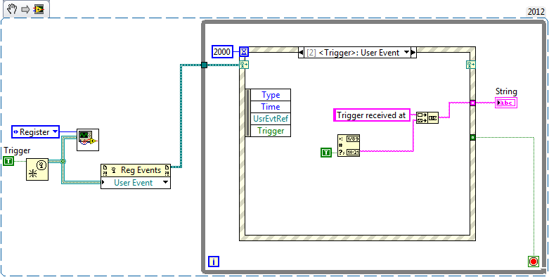

The VI that waits for the trigger (using a User Event, but a queue or notifier works too):

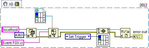

The VI that sends the trigger (opens a reference to the functional global and then runs it with the "Set Trigger" action, which generates a user event):
