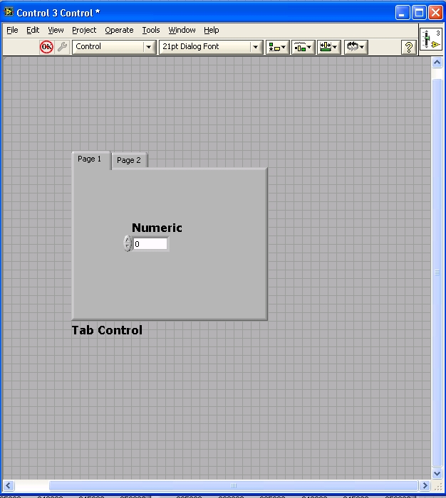

Sorry if I was unclear.
here's an example of what I want to accomplish. Suppose that I want to create a custom control with a tab control in it.  You can't add an anything in the tab control.  Is there a solution to do this?

Can't do that either. The reason is similar to why you can't put a tab inside a cluster. The tab doesn't act in the same way as a cluster. It's not a container of other controls in terms of datatypes. It's a visual container only. If you place a tab control and place a control on each page, you will see two terminals on the block diagram, not a tab "container". Thus, when you try to place a control inside a tab that's in a typedef you are essentially doing the same thing as placing two numeric controls on the front panel of the custom control that are not inside some logical container. This is not allowed.

It would be, but due to the technical reasons I indicated above, you cannot do so. The tab control has to go on a VI, not on a custom control. It may work with an XControl, but I've never tried that.
