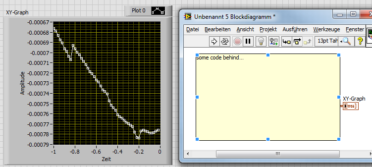

simple as this:
Just some functions: ReadSpreadsheetFile, IndexArray, Bundle. A FOR loop iterating over all points and filtering only those with X&Y<0.

Hi jyot,
dunno why you need interpolation functions here.
I just used a FOR loop to filter the points with "IF X<0 AND Y<0 THEN…"
