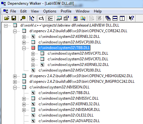

Sorry to bump this old thread, but I have a related question.
I tried to decompose dependencies of the problematic DLL, and dependancy walker shows calls to wrong library.
Problem is, that the call comes from a library allready build.
If someone using MSVC OpenCV build knows how to force a build without this dependency problem, please shed some light.
I used some standard average joe tutorial with c-make.
Message 9 of 10
(6,876 Views)
You can't force Windows to load a different DLL with the same name in an application that is already using a DLL, unless you use SxS which requires both DLLs to contain a manifest resource that specifies its version and compatibility and install the versions into the SxS directory or as private copy into your application directory. All applications and shared libraries using that DLL need to contain an according manifest resource too.
Since Intel chose to normally have developers install tbb.dll and related into System directory, SxS is not an option. You would not only have to install the library that LabVIEW is using into SxS and relink it to contain the necessary manifest resource but also add a manifest resource to LabVIEW itself, or whatever dependant DLL links to tbb.dll.
The only feasable choice you have is to find out what version is already installed, and find a proper installer for the version you need, and install that over the already installed version if it is newer. And then keep your fingers crossed that Intel didn't introduce binary incompatible chances to the new DLL. And of course when you distribute your OpenCV based library/toolkit or whatever, you have to make sure any user is installing that version of the tbb.dll distribution too. That installer needs to check for an already installed tbb.dll check it's version and if older replace it by the new version, making whatever registry changes there need to be.
