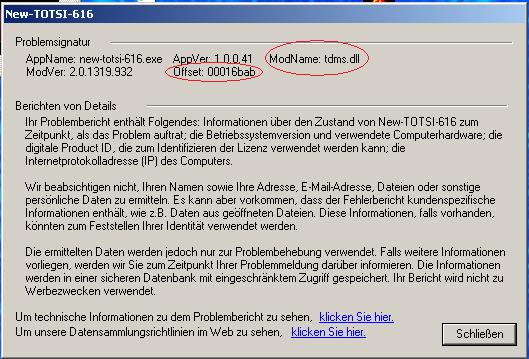

Hi,  I have a more or less serious problem with LabView 2009. When I run my program on the development machine its causes no problems.But when it runs on the measurement machine the program crashes after some hours.  Windows detected a problem with ..... and the program was stopped would you like to send the error toMicrosoft .... blablabla..  Has anyone an idea where this problem could come from?

The tdms.dll version is 2.0.1319.932
Only a reinstall of th 2009 runtime did not solve the problem.
