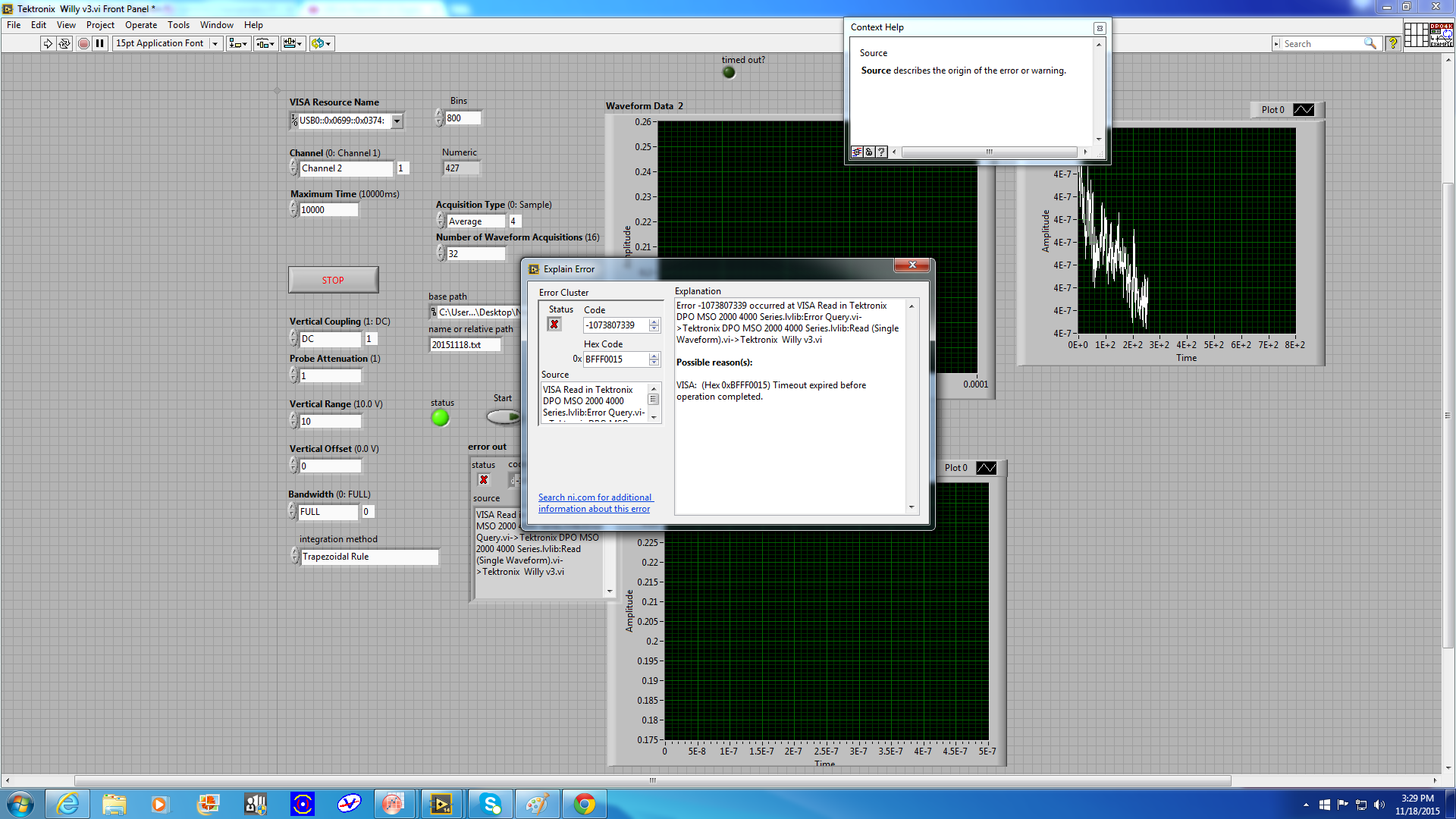

I got a problem when using Tektronix DPO2024 to scan.
The error -1073807339 happended when I scan many times.
Do you have any suggestion for this part?

Are you triggering your oscilloscope? It might be waiting too long for another trigger.

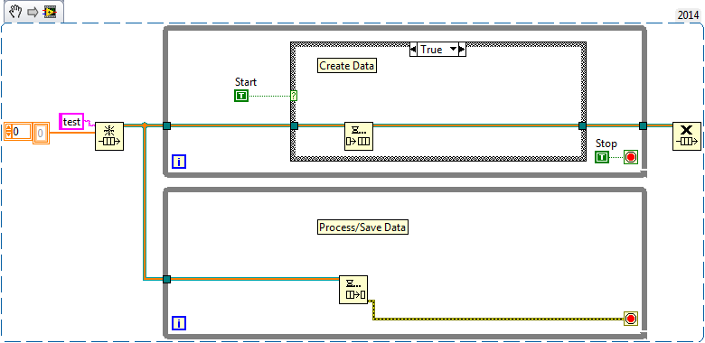

I noticed you are using a queue to pass data around. However, you are losing one of the main benefits, which is that you can pass data to a parallel loop and view/manipulate it without slowing down the acquisition. To get your parallel processing going, you will need to make a second while loop with all of your dequeue element code in it.

Hi gregoryj
I didn't trigger the oscilloscope. Actually, I can scan at the beginning, after scan time is much than 200 or more, the error is random happend.

Hi Willy,
I am not sure what is going on with the oscilloscope. As far as the parallel loops go, I've drawn a little (non-functioning) snippet for you. Here is your program now (with all the functionality stripped out):

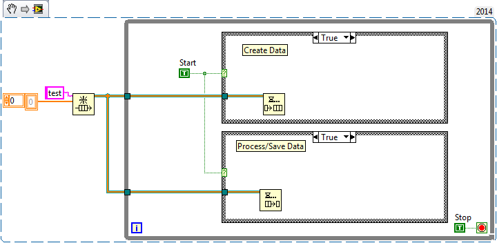

If you move the "Process/Save Data" portion to a parallel loop, you can have both things happening in parallel. It would look something like this:
There are many ways to stop the second loop. The way seen here (which I don't use in practice) is that an error will stop the loop. The error comes because the "Release Queue" function was used after the top loop stopped, and when the dequeue element tries to take an element out of the non-existing queue, an error will occur. In practice, I usually enqueue clusters with at least 2 elements, one element contains a command (like a string or enum) and the other contains the data. In this way I can command the bottom loop to perform an action, or to exit.
Look up Queued Message Handler (QMH) in the examples and on the forums for more examples on this technique.
