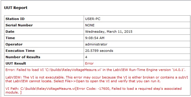

teststand error states that a vi failed to load in the Labview Run-Time Engine
Yes, I can launch the test panel in MAX and it works just fine, so I know that all the drivers that it needs are on this system,
I just need to figure out how to get teststand to get my labview VI to toggle these lines like it does on my development system.
If I am interpretting this correctly, teststand doesn't like the version of labview that my VI was created in...Is there some way to configure teststand to use this version or do I need to recreate my deployment with whatever version teststand will use?
If the later, how do I determine what version that is?
Thanks again for your help in sorting this issue out...

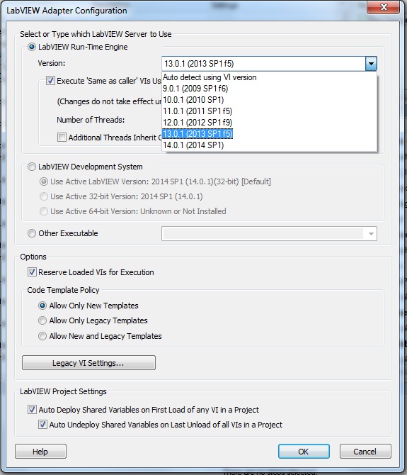

In TestStand, Configure->Adapters->LabVIEW.
Select the LabVIEW Run-Time Engine and explicitly pick the one that matches your VI.

I tried your suggestion and these are the choices that teststand gives me:

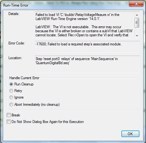

If I select 14.0.1 (2014 SP1), then I get the following error when I run teststand:
If I select 13.0.1 (2013 SP1f5), then I get the following error when I run teststand:
Not sure what to try next...

Which version of LabVIEW do you use?
I would do a forced recompile of your VI.
In my experience, the LabVIEW development environment does a good job of recompiling and adjusting for minor version differences.
TestStand doesn't do this so even minor version mismatches cause that -17600 error.
EDIT: Also, do you use any packed libraries? That's the other case where I see this issue a lot when a packed library is compiled under a different version of LabVIEW.
