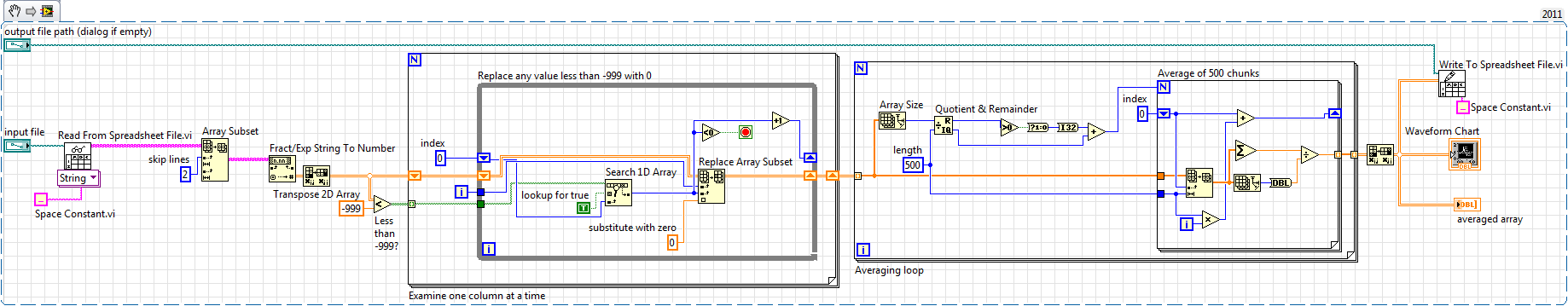

(3,618 Views)
Project complete, almost anyway.
If you are planning to submit this, you better understand how it works. Also, if you have saved some time because of this consider giving that time to a charity of choice!
Here:
Spoiler
CLA CTAChampionI'm attending the GLA Summit!
Subscribe to the Test Automation user group: UK Test Automation Group
Message 4 of 13
(3,605 Views)

Hi Mahisnair,
you may try that one:
Remember: it's never a good idea to include multiple spaces for better looking text files 😉

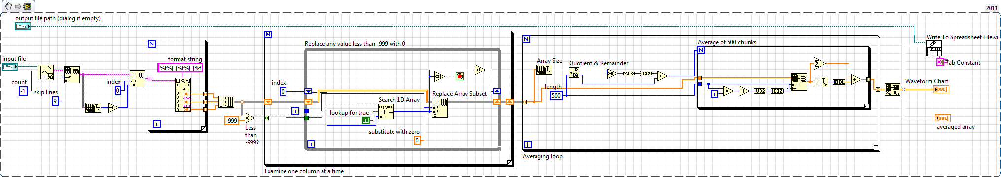

Another version, just drag and drop:
