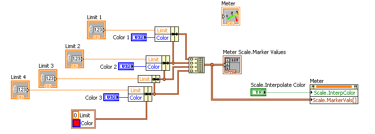

a meter is a nice indicator. I always change its colors by setting two properties:  Scale.Interpolate Color and Scale.Marker Values[].
LV 9.0 example is attached.
Message 5 of 8
(7,020 Views)

Hi Scott,
I'm sorry but front panel screenshot is everything I can do now.
Regards.
