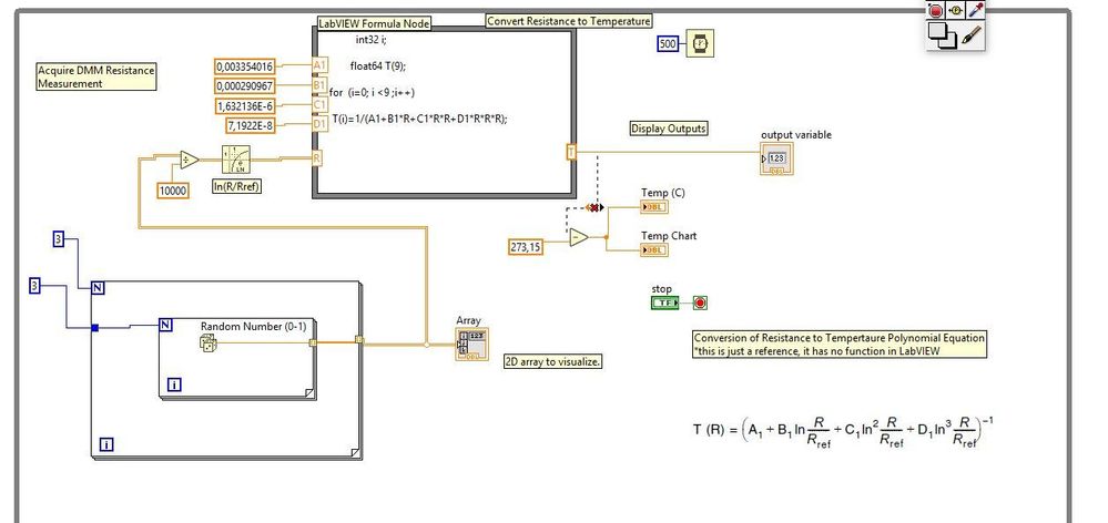

i  found the example mydaqthermistor which converts the  Resistance ( from daq) to Tempertaure Polynomial Equation..
i want to modify it and as an input for the resistance to have a 2d array of random numbers and as an input a 2d array ( for  every resistance value showing the temperature )
however i cannot find the correct modifications !!! i tried a for loop, i deleted the dynamic data converter i changed the output indicator but it constantly shows errors..

Why would you use a formula node?
The Math Primitives are polymorphic over array size and dimensionality.  Then you don't need to figure out how to declare an array of NDims

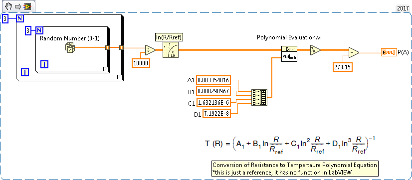

Or you can use the Polynomial Evaluation.vi located in the "Mathematics"
