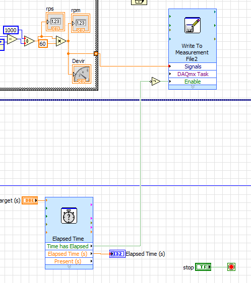

I want to record data to a file while the measured values are running,going on screen.For now I only successed to record data for a specific time period but also the measurement loop stops when the record time stops.How can I do a vi in which the measurement goes on without depending on time and whenever I want to start the recording I push  a button and the recording for a specific time period starts?Please help I feel desperate

Thank you for your answer but I want to start this recording action with a record button I cant figure out how to do this? How can I do it?

The code has a number of issues, like the express VIs and using the wrong timing functions, but beyond that it looks like you are wanting to read a new data point every 100ms for some period of time and then stop. Yes?
Why are you reading the points individually? 100ms equates to a 10 Hz sample rate. Assuming you are wanting to acquire data for 10 seconds, that's 1000 datapoints. So configure the daq to acquire 1000 points at a 10 Hz sample rate, and you're done -- the timing is exact, and no loops.

Actually its an encoder measurement.I located a simulate signal on purpose instead of DAQ.So I want to measure RPM with an encoder so record these data to a file.
Considering these how can I trigger recording with a record button?

it doesn't work ,time limitation continues with the while loop so it does't limit the recording time.Every time it reaches the target time it starts again from zero time.

There's two things wrong. The program structure, but also the way you are doing the measurement. You need to be using a counter, configured as an interval counter -- check the examples that ship with LV. Get that going correctly and we can talk about program structure. No Express VIs. It's time to take off the training wheels.
