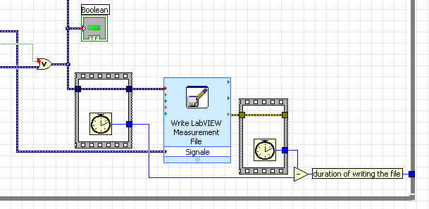

Hello I am trying to find the time elapsed during writing a file: using express vi-> 'write to measurement file. vi' I want like a stopwatch to measure for how long the express vi is being used and develop a logic to stop it after 'say- x seconds'. I am attaching my vi and a picture for further clarification: Thanks in advance for all your valuable advices

Hi Thanks for replyig. I have set up the sequence structure but I dont know how to start the clock 1 when data collection starts. Please advice me about the same. An example would be highly appreciated. Thanks in advance. Vaibhav

as i said already here, http://forums.ni.com/ni/board/message?board.id=170&view=by_date_ascending&message.id=332115#M332115 i think you can´t stop the writing process. If you start them, then you have to wait til the vi is ready. To measure the time you can use the "Tick count" function. See the attached picture.

Hi Thanks a lot for the reply. I understand that using the normal file inp/outp. would be far lot messy. However i am asked by my supervisor to use this express vi, as the code is almost done. and have no options. Please advice how can move round this, at least get the work done is now the main objective. I made the same branch as you have attached in your message. But it gives some random numbers and not the time difference between the start of the writing process and end of the same. Could there be a wring problem?? Thanks again for all your most valuable advice. Kindly help be a bit further to get out of this tricky situation. Vaib.
