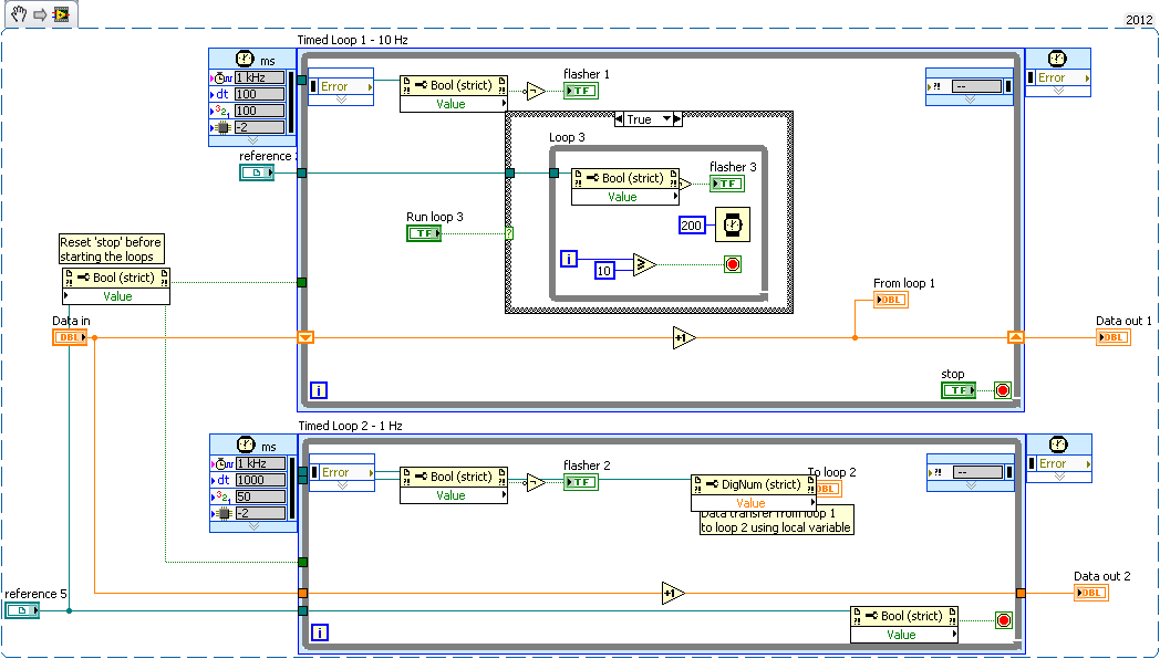

Either use two (timed) loops in parallel or place part of you code in a case structure that executes only at certain time intervals.
Placing a 2nd loop inside a loop will pause execution of the 1st loop untill 2nd loop finishes.

so I have to create 2 parallel timed loops? how to create parallel loops? it means 1st loop into the 2nd loop or it means 2 loops separated and connected?
I'm very new to labView and I've never used parallel loops or timed loops..

Parallel loops are separated, like this:
Do not wire outputs from one loop to an input of the other, this will cause the 2nd loop to wait on completion of the first.
Placing a loop within a loop will pause the outer loop untill the inner loop finishes.
Drag the above snippet int an empty VI and look at the loop speeds (flashers).
For more info on loops, I refer to the LabVIEW help & examples.
Hope this helps.
-- Edit -- : The snippet tool messed up the code a bit, I'll attach the VI.
