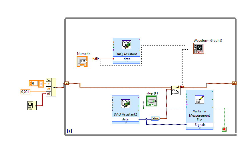

I'm working on my Diploma work and I need help with some problems. I want to try acquire some data from my system using Labview insted of matlab /simulink. I need only some simple function's to acquire and plot data.
I have my system connected to the NI USB 6009. After start program I want to acquire output of system (it's working) plot it (working) but there comes problem in single graph i want to plot system output and NI USB 6009 output (now I'm doing it in 2 separate graph's) step response. I find out, that can be done with using array but it does not work for me... Collected data written in excel worsheet (date/time and system output). There I want to write into the worksheet only 3 columns, 3 values : " time in seconds | NI USB6009_output | sys_output"

Although you convert the scalor to an array, you are passing a single point to the Waveform Chart, so you won't see anything.
I did not get a mental picture of what you want to achieve, just bits of information, but I do not understand why you needed 2 separate graphs.
Maybe the best approach is to fix one problem at a time..  ...maybe...

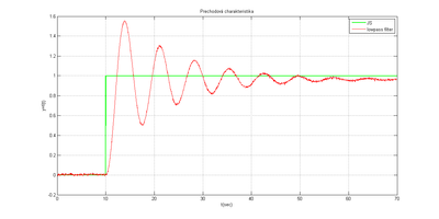

I want to plot 2 diffrent types of signal into single waveform Graph as it is described at the picture.
On the graph i want to have 2 curves: AI and AO. dp.png
something like that: js_sekundy+filter.png

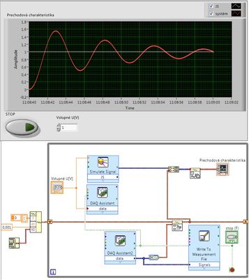

You were close to the solution, but using the wrong function.  Appending the waveforms will display one then the other.
To superimpose, first create an array and use the function Align Waveform Timing.
See image below:

Thanks a lot, I changed it upon your suggestion and it works! (not precisely what i want but close enough) Thanks.
