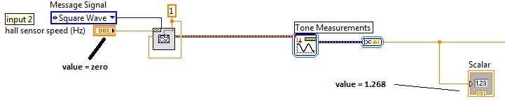

hello everyone, i'm using the tone measurment.vi to measure the frequency of a square wave from 0-15Hz. when i start my program, the frequency of my square wave is zero, but the output
of the tone measurment is 1.268, while the program is running i can get the value to zero. but it is very important that the value in the beginning is zero. i hope someone can help me with this.

I don't really see a problem in the jpeg.
Can you put the specific VI online?
