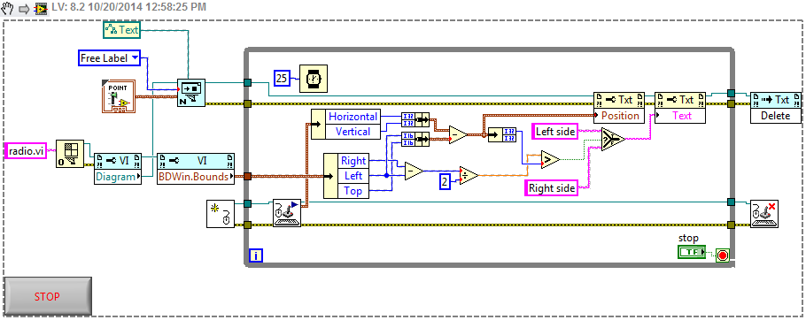

I couldn't find a block diagram property related to Tool Tips, but here's a very rough pass at a crazy idea.  You could create a free label that follows the mouse pointer over the block diagram (or gets put wherever you want it) and adjust the Text property as appropriate.
Jim
