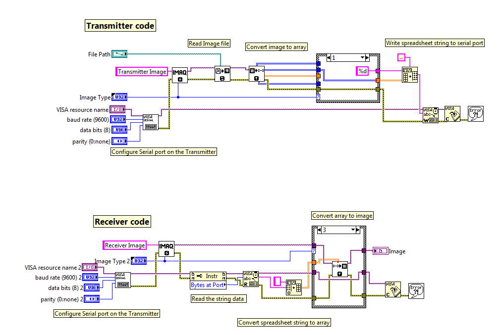

Thank you for sending me what you have done so far. You are very close to getting it working.
Here is an image of some code I put together, let me know how you get on
I have attached the code as well.

Hello i have finaly manage to transmit images! The issue that is require about 14 min for a jpeg, 640*480, 50kB image. Is it any way that i can reduce the time needed for the transmission. Please find attached the code i used

Hi Ariadni,
That's good news! You have made a considerable about of progress. Have you tried increasing the baud rate (bps Bits Per Second) The spec sheet says the device can handle up to 115Kbps
Let me know how you get on
