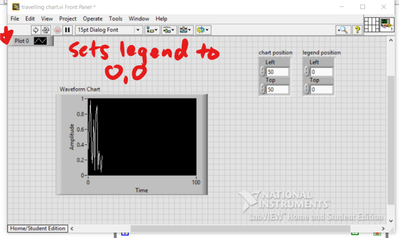

This is actually really interesting behavior! I looked at it and at first I was also confused about why the chart would be traveling from iteration to iteration, since you are just putting a contant value into the position. But I think it is actually the intended behavior. If you look at it more carefully, here is what is actually going on:
Basically, the thing to note is that moving the graph with the position property also moves the legend, and that is causing some weird behavior in this case because you are also moving the legend itself.
--Hope

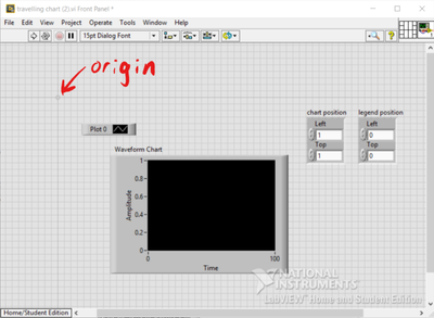

Yes, the positions for both of those properties refer to absolute coordinates relative to the origin.
Here is where the origin is on your VI:
The "left" parameter is basically specifying how many pixels to the right of the origin to place the graph, and the "top" parameter specifies how many pixels down from the origin to place the graph. I think each grid square is 12 pixels.

I guess maybe something that's confusing you is that the origin is not always at the top left of the visible front panel (the front panel will let you scroll to negative coordinates).
If you want to force the origin to be at the top left, you can do that yourself using VI property nodes, or there is actually already a VI that will do it for you. Just go to VI Package Manager and download the MGI Application Control package (it is free) and use the VI called MGI Origin At Top Left.

No, the origin does not change every iteration of the loop. If you read the documentation for the position property, you can see that it says it sets "the position of the top left corner of the bounding rectangle of the object". That means that it sets the position of the entire graph, including the legend. But then you move the legend by itself back further. This means that over time the graph and legend get further apart from each other. That's why it looks like the graph is moving, not because you're not setting absolute position. I think my pictures above explain this really well, if you look at them again more carefully.
Try turning on highlight execution and watching what happens, that should slow it down enough to illustrate what's going on for you.
I totally agree though that this is very unintuitive!
