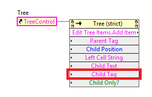

Are you sure the last one isn't "Test_step1_2"? The Tags have to be unique, which is why it is appending stuff. You can take control of the tag name when adding items by not leaving the "child tag" input blank:
Pretty sure I am not leaving Child Tag blank. Even when it is not blank, the _n still happens.

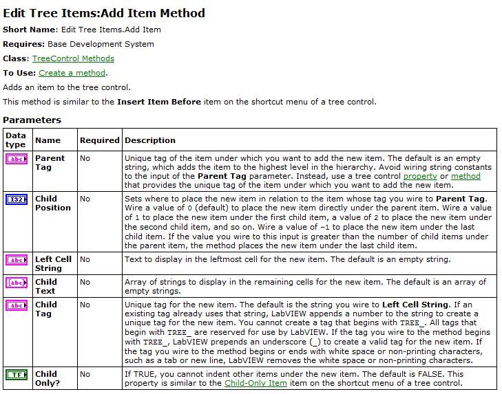

Accepted by topic author njacacia
If you read the help, you will see that tags must be unique and the documented behavior.

Yeah the tree can appear however you want, but to identify any single item in the tree you need to reference it by an alias, which is the tag, and that needs to be unique for all tags.  So one way to get around this might be to have a Tree look like this.

This of course only works if you aren't allowed to have two folders with the same name at the same level.  And I mean even if you would allow that how could the user of the software understand what is what?  Anyway just be sure and give unique tags, and one way to help this is to include the full path of the item in the tag.

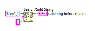

If you don't use underscores for anything else in your tags, you can just "search/split string" to get original step name.
There are underscores galore in this program. Smiley Frustrated
