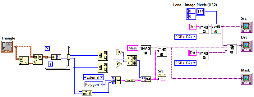

Hello everybody.
I wonder if it's possible to create a ROI with a triangular shape, because I only see rectangular and linear ROI conversions. I need to do it programmatically, not manually.
Thanks in advance.

I'm testing a Localization implementation using a Kinect device, as you kno this device can recognize depth data in 3,5 meter distance with a 60º FOV. To simulate this, I was thinking about to create a triangle of ROI in a map and detect borders with "extract contours.vi" like Kinect do with walls in a real world. By this way I can compare real measures of distances with my Kinect with simulate distances in a 2D map using pixels like poses and contour points in the edges of the map like obstacles position.

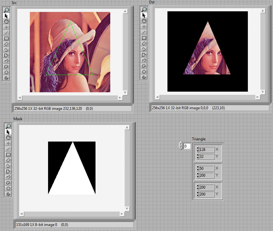

With IMAQ Vision something like that:
Result:
Hope it helps a little bit.
Andrey.
Message 7 of 8
(4,713 Views)
Wow. Thanks a lot Andrey_Dmitriev. This is what I was trying to do.
