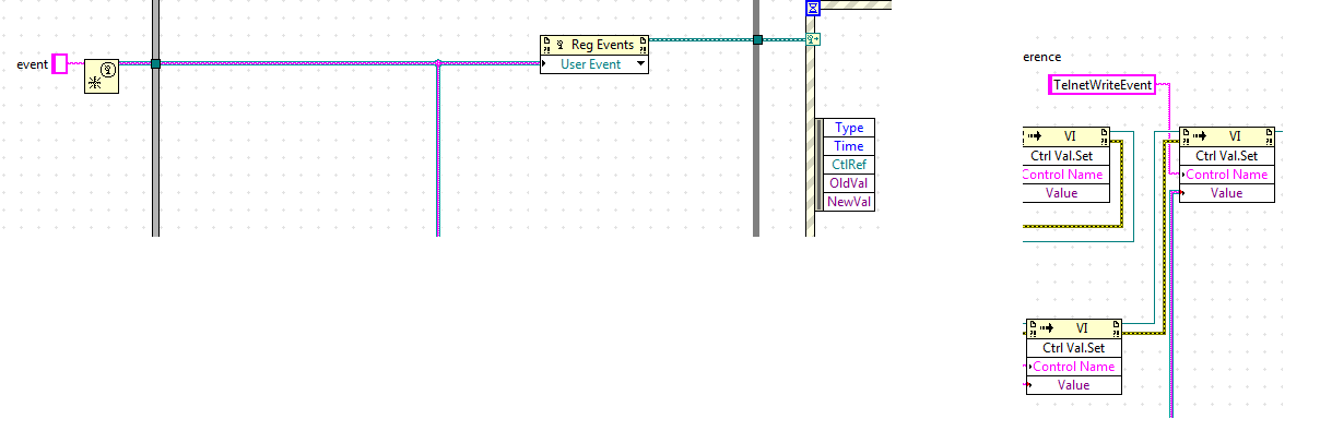

This is the screenshot of the relevant section of my main VI....on the left you see I create a user event and dynamically register it, and on the right you can see that same event (entering vertically from the bottom right) is assigned as the Value property of the subVI control called TelnetWriteEvent...not shown here is right after assigning that control value, I insert the VI into the subpanel.

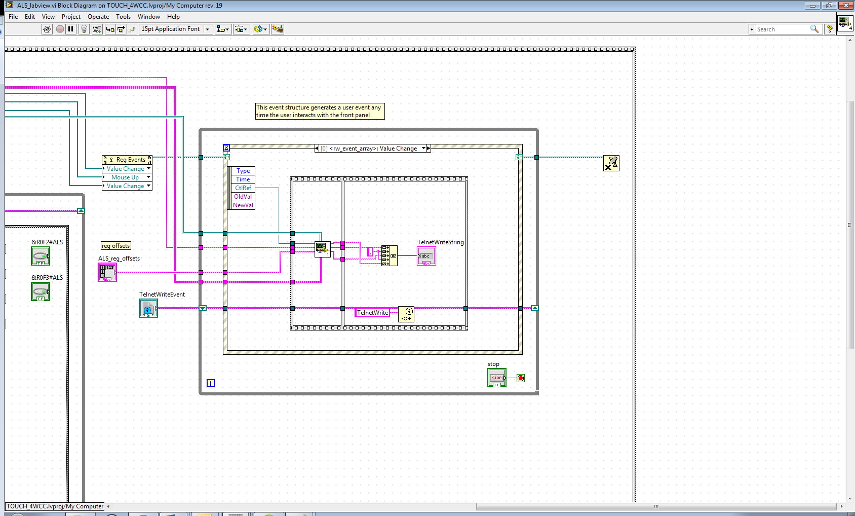

Here's the relevant portion of the subVI.  Here, I have registered various controls for value change or mouse events, and you can see in the lower left of the event structure I have a control TelnetWriteEvent on which I want to generate a User Event when any of those registered events occur:
