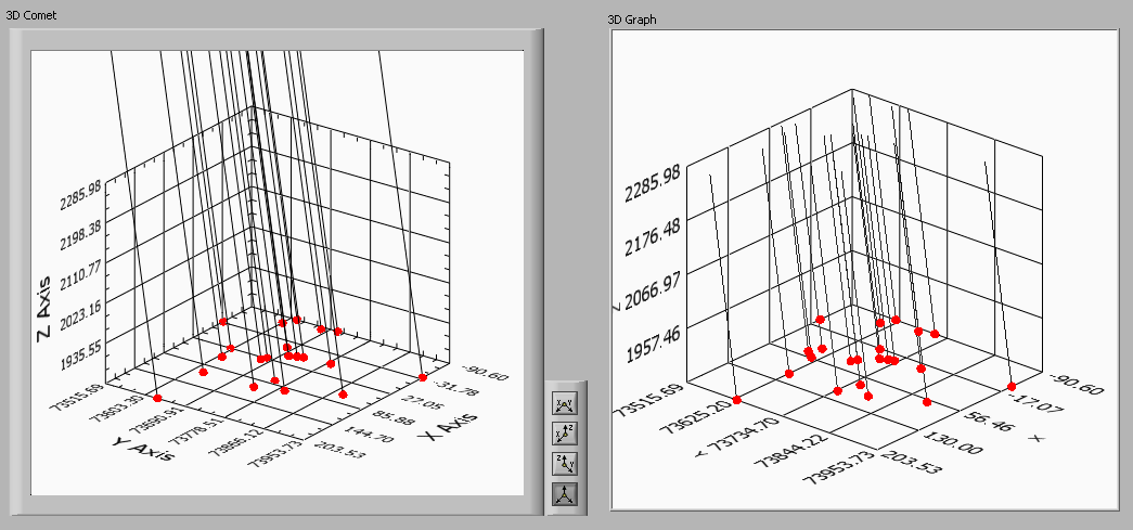

You should be able to plug the same data into the good old-fashioned 3D Line Graph and get the trajectory without the animation.
(4,088 Views)
Yeah, the line graph works well, but I am psychotically obsessed with the style of the comet graph. It's perfect for displaying a trajectory. I suppose it reminds me of the cheesy fake NORAD screen from wargames. I've tried to mimic the comet graph style as closely as I can using the 3d line graph, but there seems to be no way to get the 3D line graph to render a portion of the trajectory outside of the specified axes range, as the comet graph does. This doesn't look as sharp when zooming in on the trajectory endpoints.

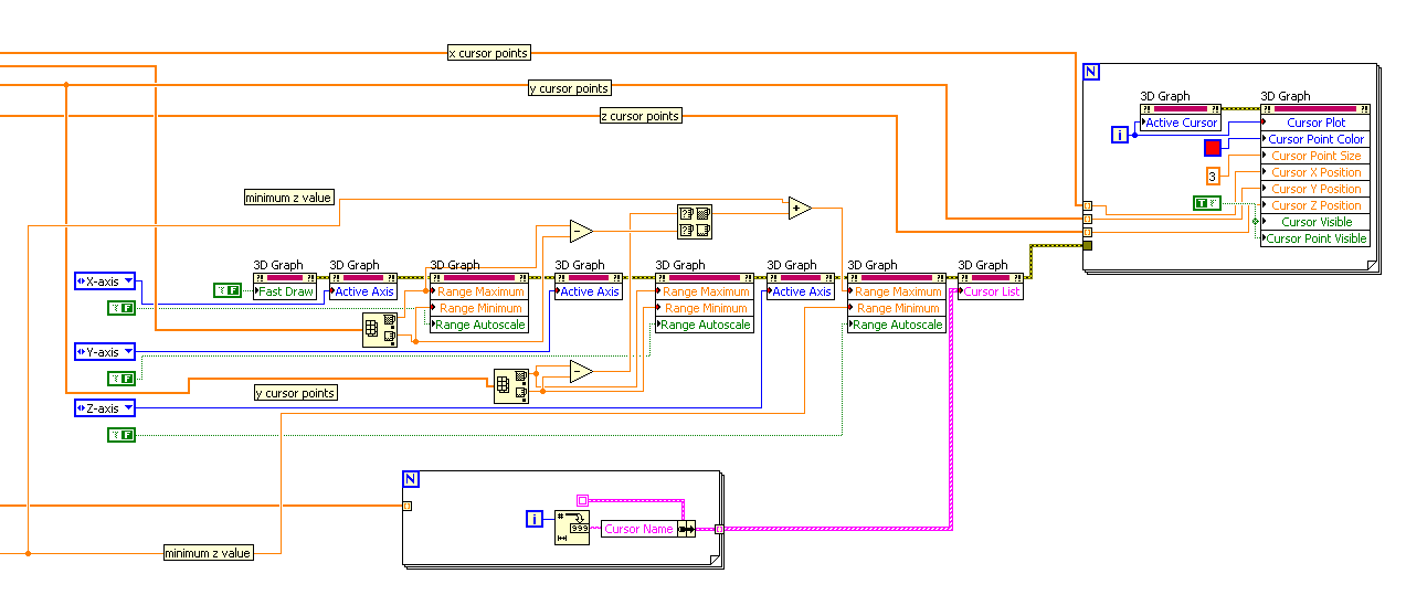

It's also a royal pain in the rump to modify the graph style programmatically for multiple plots. You have to "switch" between active axes and active plots and active cursors and modify each one separately which is very very sluggish.I wonder if NI will refine the 3d graph functions to be less.... clunky.
