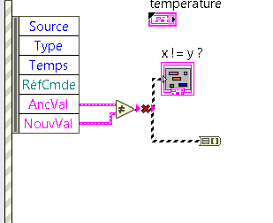

I have a type def containing some booleans, arrays, etc.. and I would like to check which element was changed in the Event Structure. My first tought was to compare the two clusters, get an array of booleans and follow with a For loop. But I found that I can not convert this to an array.The error is something like "A polymorph terminal can not accept this type of data".
See figure
Any other suggestions on how to accomplish this ? (I do not want to make 7 or 8 user events for each element).

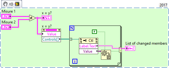

Something like this may help:
Paolo

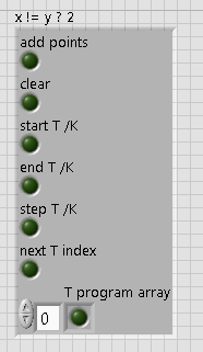

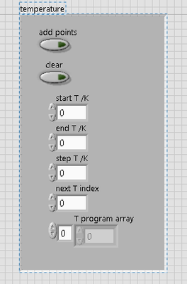

Hi
This is my cluster
The cluster of boolean looks like this
so the comparison of the two TypeDefs having the array is giving the problem ?
thanks

Sorry, the example I uploaded work only for simple types, not for arrays or clusters in your main cluster.
For arrays, things get a little more complicated.
Paolo
