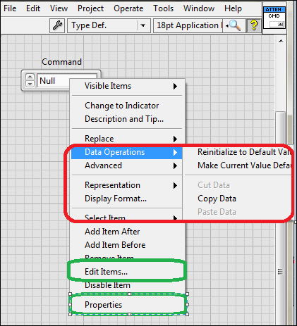

That sounds a lot like you are in the Right-Click menu shown in red rather than either of the green menu options witch would open the items editor.
You don't want to operate on the data, you want to change the data type's items property.
