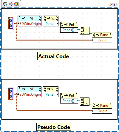

If you press Ctrl+a in the original VI, what does the selection show?
Somehow i got the feeling you got fooled by a screenshot of code in the block diagram....
Norbert
I think the same...
@ziedhosni: Download the attached VI and check it out yourself, is your block diagram behaves like a 'Pseudo Code'...??
Actual and Pseudo Codes

I tried to copy paste the actual code in a new VI  and Then I used the clean up tool, I got this picture below,but when I tried to put the actual code in the VI where the clean up is disabled, I got the pseudo code which is the same as the actual code. Is this what you want me to do?
My intention to share that code (Actual and Pseudo Codes.vi) was to illustrate what Norbert_B has suggested:
If you open the code I shared in previous reply and try to select and drag any node/wire in the Actual code and then do the same in the Pseudo code, you will find the difference in actual LabVIEW code and Pseudo code (picture/snapshot of the same).
