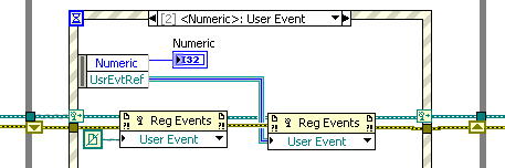

Shane,
attached screenshot will work without creating any errors. The reason is, that the existence of events does not depend on its registration. Using registration, you only prepare the eventqueue to potentially dequeue elements of this event type. If you have not registered for this event type, i would say that it even isn't enqueued, but i don't know for sure....
I must admit that my example is a very rare case of usage, if it is used at all, but it is possible....

Norbert,
isn't the code you posted a no-op?
You're bascially unregistering the same event you're re-registering......  Just because it doesn't throw an error, doesn't mean it makes it neccessary.
Is there some reason why this may be required?  According to my knowledge, the UsrEvtRef available within the event structure is exactly the same as the one you are trying to unregister and re-register.
I'm aware the events and the registrations are different things.  This is why the presence of the refnum in this position is, for me, unneccessary.  In fact, I'd almost prefer it to be NOT available.  Then we have a real read-only situation when we pass a Reg Events wire to a VI.  The VI has NO way of getting to the actual events behind the event handler...... At the moment, any VI receiving a wire of pre-registered Events can fire any of the events it receives.  It is possible to buffer all event references received and then fire them whenever needed.  This would, IMO, weaken the usage of passing a pre-registered group of events to a sub-VI.

Shane,
as i already wrote, this could be done, but is a very rare case...

One example where this could be useful (perharps):
Image a continuous running loop creating a user event. A "consumer" reacts on those events. Now, due to different external infos, the event case could take very different amounts of time for execution. Since the "producer" still generates the events, you would maybe enqueue many events which are not of interest anymore. So maybe you want to unregister the user event in cases of long executions within your consumer. But after the execution of the event-case has finished, you want to re-register the event to continue working on them....
Sure this is quite abstract and virtual, but possible. Nevertheless, you are correct that there is no really obvious reason for the eventstructure to expose the user event reference.
Norbert
