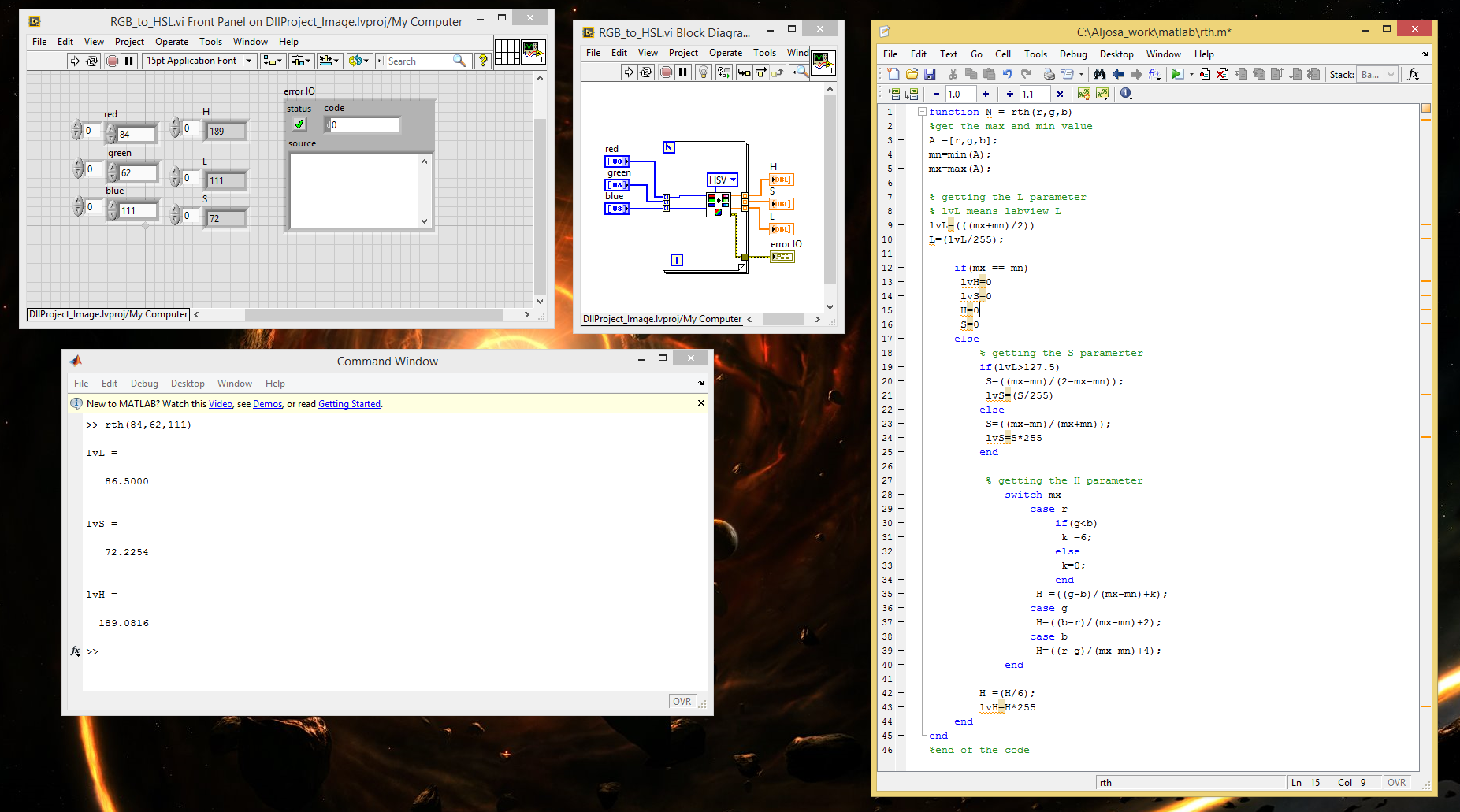

I know that labview uses the RGB and HSV values  in range from 0-255 and not in degrees or percents. On the net I found some code examples  RGB to HSV conversations. Implemented it in Matlab and compared it with the VI IMAQ RGBTocolor 2 function. The Saturation and Hue parameter did match , but not the Lightness parameter which is the easiest one to calculate. This Why is the L different? What does Labview do instead?

Here is the screenshoot, lvL means labview L(ightness) value:

Based on the following Wikipedia entry your Matlab code calculates the I parameter of HSI representation, not the L one from HSL. If you set the Color Mode input of the VI to HSI you will get the same result as the Matlab code.

thanks for the help. I have changed it and now all the parameter mismatch 🙂 But when I try the RGB to HSL converter on the net the values H, S and L match. strange, like Labview uses their own formula. I have added a screen.

the explanation in this case is the same as the previous one. If you use HSI conversion mode in the LabVIEW VI and convert the 0...255 outputs of the VI to degrees and percentages, you will get similar results to the web based converter.
