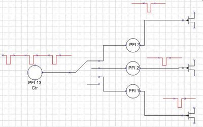

My application is to simluate a short line interruption in an electric sensor connector. The sensor is connected with 3 wires, each of which shall be tested individually. Logical high means line is connected. Logical low interrupts the line.
This is what i've got:
Pulse is only a few µs long. Therefore I cannot generate it from DIO but rather with a counter. As mentioned before, exporting a signal from counter to PFI works fine. However, resetting the PFI to logical high pushes me past my borders.
SchematicHello
