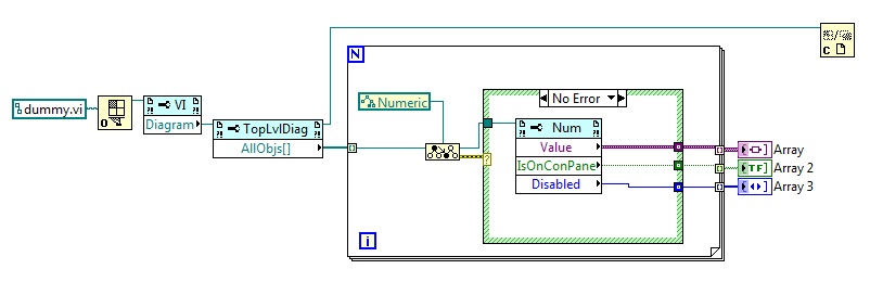

I'm having some trouble getting it to pull the data from the property node... I've created a dummy vi with one numeric control on it... but I can't figure out how to pull the info from it.  I keep getting a "Type mismatch" error from the "To More Specific Class" vi.... it's a numeric control I'm not sure why I'm getting this
20391i3E0B2EACA8A604F2

Your Close Reference is hanging out there in parallel to your For Loop.  You may be closing the reference before you actually get to process in the loop.  Wire up an error wire from the loop to the close reference.  Also wire up the other error inputs and outputs as well.
If that isn't it, then please post your VI's.

I moved the close reference, still didn't do it... I'm probally just not understanding the type-casting I guess.... my target vi only has 1 numeric control on it... that's all.... but the error says it's a mismatch, I don't get it, my vi is attached
