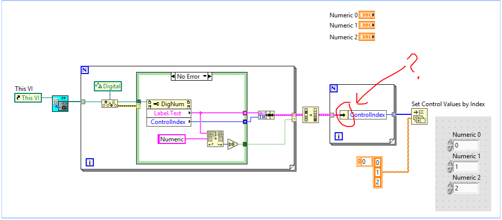

Where do you get this arrow from?

See the wire coming into it?  You might recognize that as a Cluster wire.  You are looking at the Unbundle By Name function, the "preferred" way to unbundle and obtain the contents of a Cluster.  The reason I say "preferred" is that you can see what the element is named and, especially if you have multiple elements of varying types, can be sure you are wiring to the correct terminal.  A "drawback" is that an Unbundle by Name function is twice as think as a plain Unbundle, but Good Style Wins, in my book.

Never mind, found it. It's just a cluster, but you have to wire a data type up to it. How do you convert the string "label.text" into "ControlIndex"?

Ok, I guess I should try looking harder before I start typing in here lol. Found what I needed

I got this all wired up in the way which I thought gregoryj had recommended, but now I'm running into some errors.
Maybe I'm misunderstanding some things. Why do I need to have that array for Control Indices?

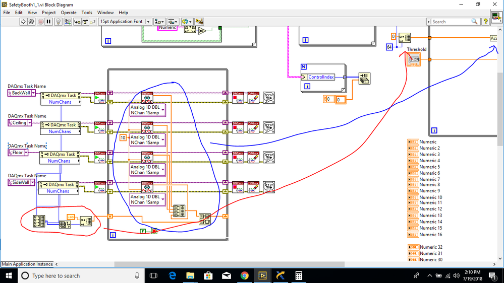

I have no idea.  You are now showing you have a larger VI, but you aren't actually showing it since it is a cut off screenshot.
It looks like you have multiple pieces of code that aren't really connected to each other, much of the code only runs once.

yeah, bad screen shot. I made another version where the acquisition portion of code is moved so that there is only 1 for loop running now, but it made kind of a mess out of the wires.
I still have a bunch of indicators sitting out in open space because I'm not sure if I should wire them up or how I should wire them up
Gregoryj was showing how to use the (control index) to an array for the 64 channels, but I'm not sure if that's for showing the readings from the 9213modules or just to change the BG colors of front panel indicators. Since the array connected to the (control index FOR loop) can be a control only and not an indicator I'm not sure what it's function is.
I attached two versions of the VI: One with 2 WHILE loops and one with a single WHILE loop
