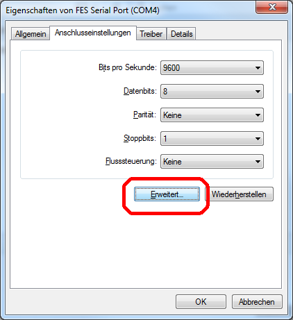

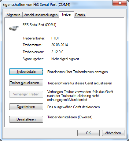

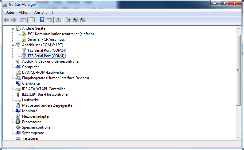

I use FTDI- devices a lot and it's quite reliable. Look at my settings:
Driver Version 2.12 is quite new, but not essential

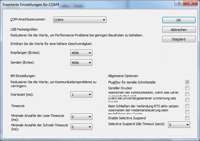

Klick this Button to configure the FTDI- Chip (the other settings are configured by your VIs settings)
These are my settings. No problems.
Are you using Handshake (XON-XOFF, DTR-DSR)?
Greets, Dave
