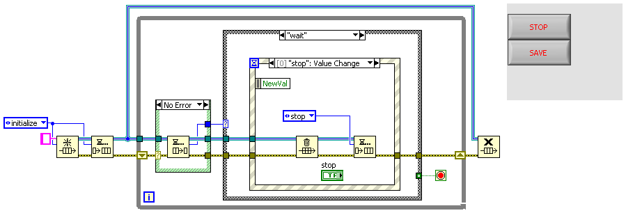

use notification to stop parralle loop
another approach using a single loop event driven state machine....event driven statemachine.png

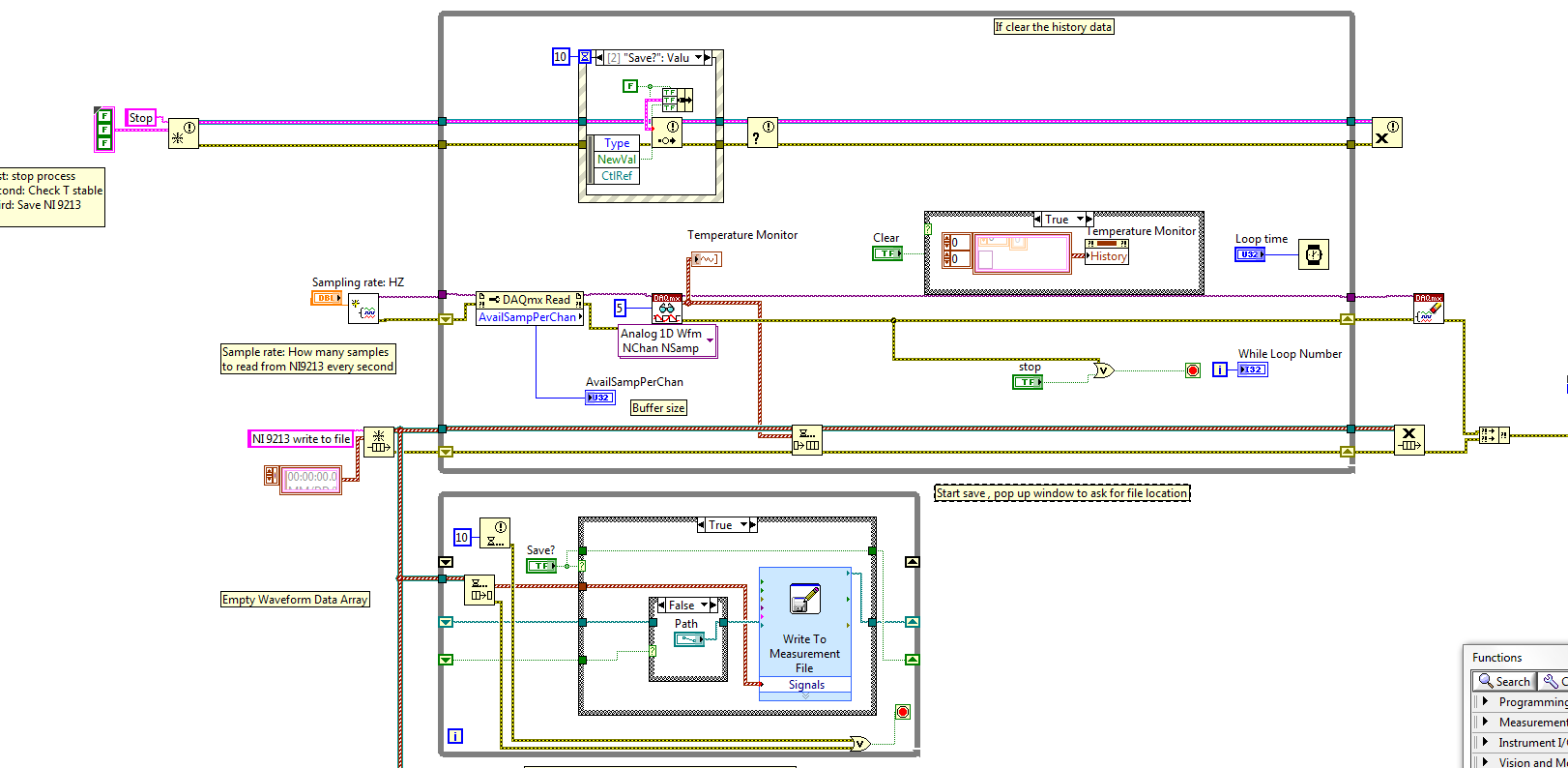

Actually I use this structure to control my valve. (event case and consumer loop)
If I use this one save data, I may also need to use SR to save the queue element . Otherwise, it will keep wait for saving message again.
I attached my case.
The first loop is displaying data in chart from NI 9213.
I used queue structure to send data to 'write to measurement file (consumer loop)'. In second loop, false case is empty , becasue save is false, I donot want data recorded in a file
In certain condition, which is determined by other device , I need to change "save " to true state, then data is recorded in a file (True case.)
After certain time, I need to change "save " back to false state,  when I need, I may need to change save to true again...
Meanwhile, I have 2 more consumer loops which collect data from com port. I need to let these consumer loops saving data at the same time and stop at the same time....
So in my case, which methods are best ?
Thank you so much

Accepted by topic author dragon-long
@MYLONG wrote:
When I click save ,consumer loop will start save immediately
But When I click stop saving , after one loop it will stop. because the SR value is still true, so saving data loop will run one more loop then stop
Is there other methods to improve this?
Think about the logic.  If you put the Save case structure AFTER the one that checks for the timeout, instead of parallel to it, it will work as you want.

Thanks. It works
