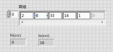

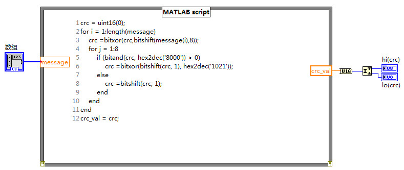

I'm using matlab script in labview to calcualte the crc16 valure of a Integer array,but something seems wrong .
The code test ok in matlab:
 the labview program test wrong:
  Is there anything need to modify? thanks!

before start to check cods as I know you have to install matlab software to use this scrip
did you install it ?
(4,204 Views)
yes,i have installed matlab r2010b , and in some other programs the matlab scripts can work.
(4,197 Views)
