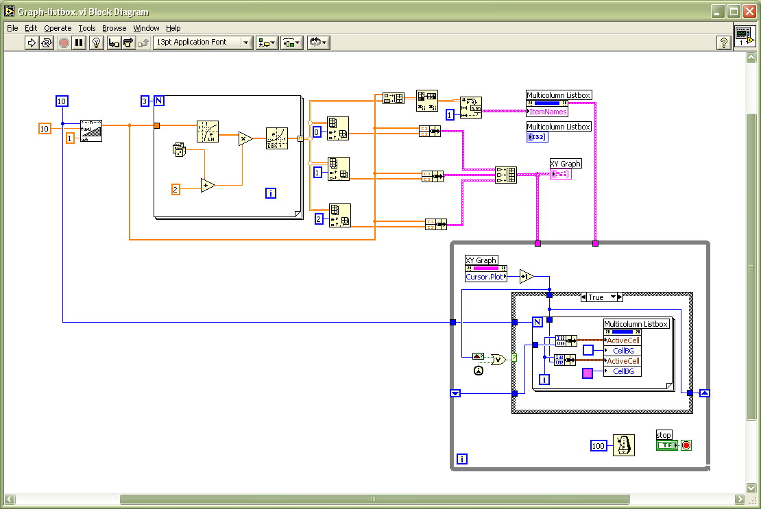

I've a data matrix of double.....this data is presented in a multicolumn listbox and is plotted in a XY graph. This XY graph has a cursor, and using his node property I can know the position of this cursor.
I want that the point selected in XY graph is also selected in multicolumn listbox (with blue line), because there are lots of rows and i want to know which colum is the point you have selected in the plot.

Here is an example.

Ok, your example is perfect!! But I want to ask another question about graphs and multicolumn listbox. In my application I work by rows....and my column listbox has about a thousand rows. I want that when I choose a point in the graph....the multicolumn listbox stand out this row (this run correctly with your example) but I want that the multicolum block go to this line automaticly and show it, because your spend time if you have to fins the selectionated row.ç

Create a property node for the listbox and use the Top Left Visible Cell property to determing which line which will be the top line shown.
