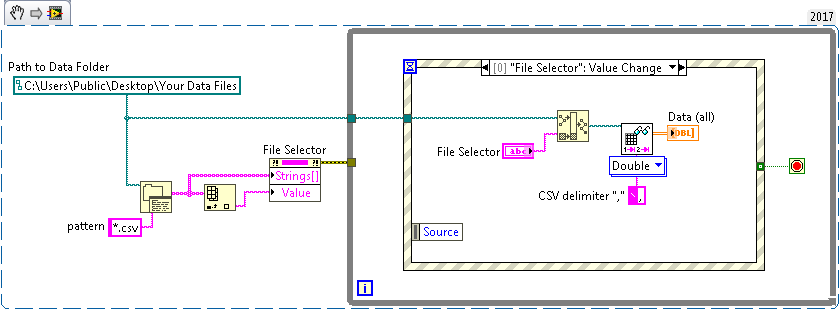

To add to crossrulz's example, this would preload the (*.csv) filenames from a directory into the combo box
