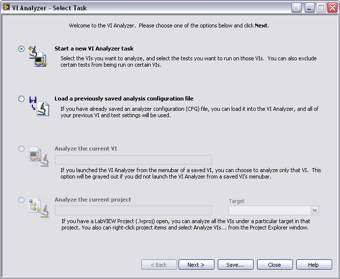

What version of LabVIEW are you using?  In am running LabVIEW 2009 and when I go to Tools>>VI Analyzer>>Analyze VI… the second option is to “Load a previously saved analysis configuration file” (screen shot below).  Is this not what you are seeing?

I'm using 2009 SP1. I know about the "Load a previously saved analysis configuration file", but the cfg file I load from here points to the project it came from. How do I make it point to another project?
