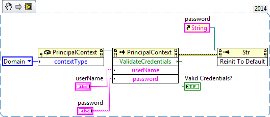

@JÞB wrote:
Just use LabVIEW to access the Windows Active Directories through the .NET code already in-place.
Telling a newbie to mess around with Windows API with .NET may be... overwhelming 😛
Regardless, here:
(5,376 Views)
